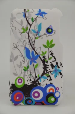

I'm trying to learn Product Photography.
How can i improve this image?
<img src="http://www.thephotoforum.com/forum/attachment.php?attachmentid=7055"/>
Use a 18% gray card, 5-10 bucks and get that background bright and white again.
<img src="http://www.thephotoforum.com/forum/attachments/commercial-product-photography/7055-product-photography-dsc_0168.jpg"/>
Thanks IByte!
How often would i calibrate?
eltif26 said:
Thanks IByte!
I do it in each environment I'm shooting in. Keep the card out of focus, calibrate your camera, press your shutter halfway; if you can lock your settings and have fun.
