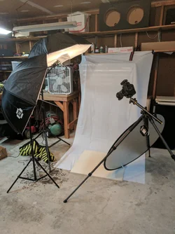

I bought the Vangauard alto pro2 specifically to boom out for these types of shoots :p
You wanna see hacky?
I bought a $1 plastic table cloth just for a backdrop and to clean up reflections.
I used spare pieces of white wooden shelving, foamcore, and my reflector to act as bounce cards and to again control reflections.
I used two lights in bounce umbrellas, one setup almost directly above the image point straight down, the other to the side at a high angle as well to cast a shadow off to the side.
I set the products on white paper where possible to give me a clean surface to shoot against. (i was shooting large car parts and ran out of clean sheets of paper and it had to go directly on the tablecloth which made it 10x harder to edit)
end result:
Not the greatest, not the worst, better than what he had . :p
as far as the background, i made sure they went back to white in post, but they were pretty close SOOC:
