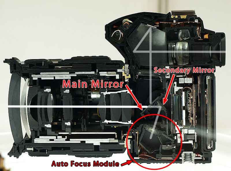

The smaller the maximum lens aperture, the less light there is available for the auto focus module to use.
Half the light the lens gathers gets deflected by the 50% transparent main mirror up to the viewfinder. The other 1/2 of the light that goes on through the 50% reflective main mirror hits a secondary mirror behind it that deflects that light down to the AF module in the bottom of the camera.
Permission is granted to copy, distribute and/or modify this document under the terms of the GNU Free Documentation License, Version 1.2 or any later version published by the Free Software Foundation; with no Invariant Sections, no Front-Cover Texts, and no Back-Cover Texts. - File:E-30-Cutmodel.jpg - Wikipedia, the free encyclopedia
