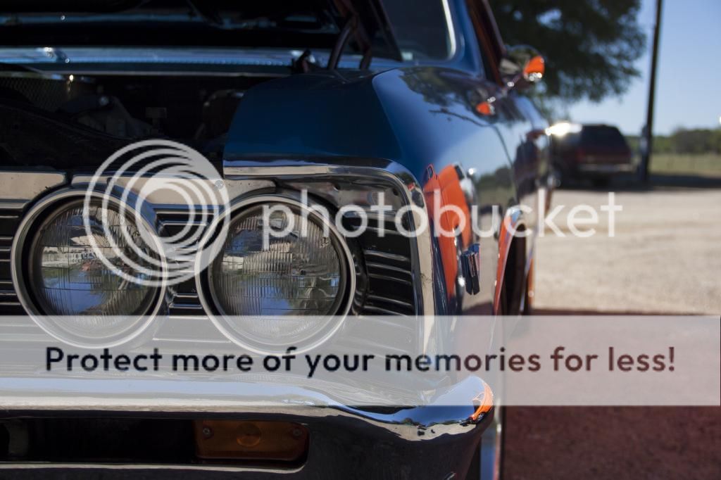

A good majority of my automotive photography is done with a 70-200 lens for the reasons KMH and Ron Lane hit on. with the shots you posted above the different lens choices wouldn't have changed as much as just a rethinking in how you shot the car itself. pull the car further out and get yourself a lot further away from the car and use your zoom. there are several free DOF calculater apps you can download for free for when your out shooting that will help you as well.
Just my experience with car shooting specifically: Cars like it up close.
One of my favorite type shots for most cars, always turns out nice imo.
Also if you want some pretty cool reflection shots, claybar the girl down, give a nice coat of wax, and you can take cool shots off of the reflection of the car. I dont happen to have an example of this.
Thank you very much for the tips. I do have a few shots like that but they never turned out nice like that I will have to try it out again.
