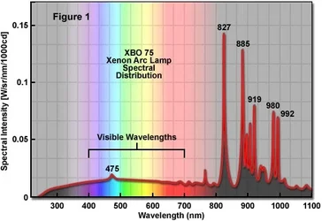

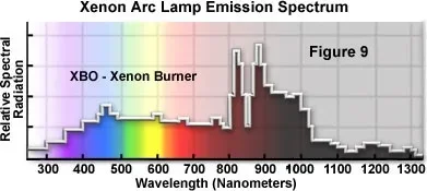

As for "black light" -- black light happens when you block most of the visible spectrum (light from 400nm to 700nm wavelengths) and only allow the shorter wavelengths through (e.g. wavelengths with values lower than 400nm).
A Xenon flash strobe (common in most flashes) puts out quite a bit of light in the 200-300nm range (far UV) and a bit less in the 300-400nm range (near UV). Black lights usually put out light in the 350-400nm range (near UV) and these wavelengths will "fluoresce" off when they hit fluorescent colored dyes. I think a Xenon flash strobe is probably putting out the bulk of it's light in a wavelength a bit too far to actually work on the subjects in a meaningful way. You could use the deepest violet flash gel you can possibly find and it will probably have a mild fluorescing effect.
A Lee filter #181 Congo Blue or a Roscolux #59 Indigo will both block most visible light and create a black light look if the light source behind them pumps out enough in the near UV spectrum. A typical florescent light would do this.
If you have enough black light in the room then you could probably get away with just using the focus-assist beam on the flash but not bother with the flash at all. You'll need to test it before the party.
? Xenon drops off quite smoothly, dunno what you're talking about. The amount in 300-400nm UV to my eye is about 1/5-1/4 as much as the output in visible range. Which would imply you should start out with your flash about 2 stops higher than normal with a UV or maybe violet gel on it, to get the beginnings of an impressive effect. Then go up from there, since who knows how efficient the fluorescence is.
A deep violet filter looks from the graphs like it would be about 20% violet 20% far UV and 60% near UV roughly
