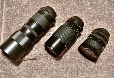

Yes, you two are exactly right. Although not a true macro lens, I have toyed with the idea of using the lens flipped around. When buying cameras on auction it was normally a group of various lenses with one or two being what I really wanted. The remaining lenses went to my odd's and end's box. There was three in the group that have potential.
