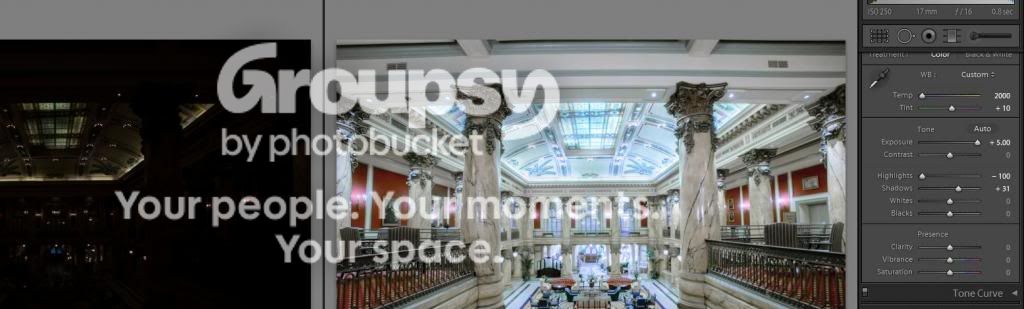

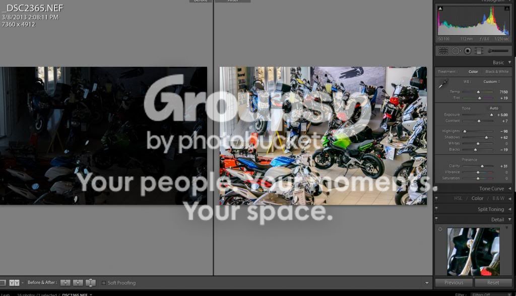

Somewhat off topic, but I would recommend you get your hands on a raw file from one of the newer exmor sensor equipped Nikon cameras. What you can pull out of the shadows cleanly with them is amazing (and this is coming from a Canon shooter).
Here are a pair of Lightroom screengrabs I did from D800 files to show the amazing amount of latitude those sensors have:
This one was pushed 5 stops and then the highlights were pulled down as far as Lr would allow. The final image is as clean as you'd like.
This is the same thing, the exposure was for the light outside, then the image was pushed 5 stops with highlights pulled all the way down.
That's what went wrong with the noisy last pic. I'd love a D800...and maybe someday I'll have one. Those screenshots are pretty convincing!
