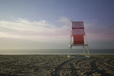

Hi,
Most of the times I use my ND filters (especially when I stack 2 of them together), I get a horizontal reddish bar roughly in the middle of the image, like the one in the attached image. Sometimes it's stronger, sometimes it's not like in this image. I noticed in backlight, and sidelight scenarios.
I'm not sure it's relevant, but I noticed with my Nikkor 24-70, and with my Tokina 12-28. As Filters I use a Hoya HMC Filter ND400, and a Hoya Pro1 Digital ND16.
What might cause it, and how to avoid it?
Thanks
See how much more noticeable it is opposite where the sun is?
It's a lens flare in the air gap between the 2 filters and or one filter and the lens front element.
Cover up your viewfinder. It's light coming in from there and reaching the sensor. You camera should have come with a simple slide-on plastic cover.
