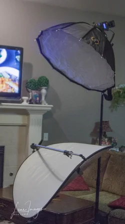

Okay, as promised @tirediron. Here is the lighting set up and one of the examples from it. The light is the streaklight 360 at 1/8th power. 85mm f/1.8 on my 7D mk II set at 1/250, f/9.0, ISO160. The image was WB and basic edits and cropped to 8x10.
Nice! I like the second version much better as far as the crop and camera angle.
Thanks Destin. Yeah, he doesn't have an 85mm. That Canon 85mm f/1.8 is a killer headshot lens. And is so sharp.
