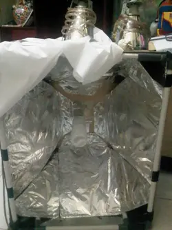

lol my wife has angrybird one .....btw this is my DIY soft box , from PVC,strip nylon and on it there are standard reflector bought from the store about $0,6 each with 23watt=100watt $4

Thats mine with the shower curtain peeled back. There was a cardboard cone that wrapped round it to make it bigger with a tin-foil interior at one point (I still had my tin-foil reflectors at this point as well), but thats long gone. Dosent look like much now, but my first 6 months of taking pictures was this light (minus beauty attachments), a 2ftx3ft tin foil on plywood reflector, and a 5mp olympus E-20.
Never used it much as a beauty dish though, could never get a result I liked. (Read into that, I didnt know how to use it).
Just a thumbnail.
hmmm...can you try to put the diffuser deeper ,thats why i'm not using reflector but plastic bowl , its to small and not enough space to spread the light , look at mine you can see the different
