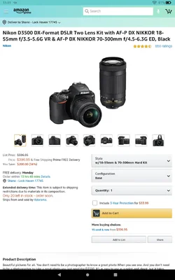

Thank you all for these messages. I am learning so much. In all your.professional opinions would a d300 with lens for 360 be a better option vs a d3500 for 400? Picture enclosed. Haha I have no idea what I'm doing! a Screenshot_20191225-231145.webp

Don't buy a d3xxx series.
Also, don't buy a d300

The D3xxx series is Nikon's entry-level. Don't be fooled by their lens packages -- you can buy those two lenses used for $90 and $130 respectively. So that right there tell you how much the camera body itself is worth.
While it has a great crop-sized sensor in it, Nikon dummies down the featureset of the D3xxx model line to the most basic functions in order to keep the "cost down." The D5xxx series is a much better platform -- So long as it has the 24mp sensor.
But I would personally recommend the D7100 or D7200 as they have a more "pro" level body, and a sensor that does well in low-light for its size. Both are also still very decent cameras for day-to-day. And like the D610, and unlike the D3xxx and D5xxx, it can drive D model Nikon lenses.
The D300 recommended above is simply too old. It was great at it's time, but simply a relic today and wasn't designed for what you need. The D700 would be a better choice, which has a better full-frame sensor, and I would still discourage it for the same reasons. (early 2000s tech, dont focus well in dark, low resolution, bad ISO/DR, etc).

Thank you all for these messages. I am learning so much. In all your.professional opinions would a d300 with lens for 360 be a better option vs a d3500 for 400? Picture enclosed. Haha I have no idea what I'm doing! a View attachment 184237 View attachment 184237 View attachment 184237 View attachment 184237
K, the problem with a D300 is that even when it was brand new, it was only 12mp and that hasn’t changed! LoL
I wouldn’t consider anything with less that 20mp and preferably 24mp.
I know if you’re new to all this it can be overwhelming but at least do better than your phone can do!!

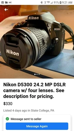

I found a D5300 on facebook market place. He was selling the base for 330. I negotiated the camera a 18 55 lens a camera bag a d an extra battery. If I get a tripod and learn how to use this damn thing will I get a good shot at the Northern lights?

yup! I'd look into getting a cheap used 35mm 1.8G for this endeavor for the speed, but start researching northern lights photography and get familiar with setting the camera up for long exposure work.
you can even just practice at night with stars in the meantime.
