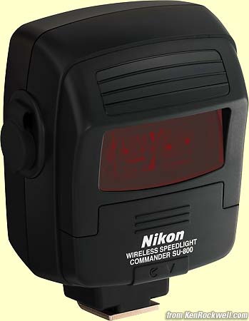

i just bought an sb800 flash for my d60 but i am having troubles getting it to work wirelessly, does anyone know how?
I dont think the D60 has a infared trigger, you'd need to buy the trigger or use the sb as a trigger for the SB R1C1 and SB 600
yeah if you want to do wireless flash you will need an sb-600 as a slave unit and use the sb-800 as a master unit
yeah thats what i thought. But the guy at the store kept telling me that was all i would need. Oh well. Can i just buy a trigger instead of a whole flash for the master?
yep, you can get the su800

If you don't have Commander Mode on the D60, then you will need triggers. Do a search for member JerryPH. He has a lot to say about Cactus triggers for wireless flash. You will not need another flash for off-camera operation, but you will need a triggers.
