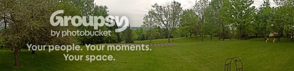

I wanted to work in the garden today but it is drizzling rain, so as before, I set up on the balcony to try & implement what I learned from the folks here with my first attempt @ a pano. I fashioned a "L" bracket to hold the camera in portrait orientation with the lens over the pivot point so as to get greater height to the picture. Using a light meter I determined there was better than a three stop differential across the field of view so I over exposed the sky & under exposed the dark areas with a shutter speed of 320 @ f11 on a manual Vivitar 24mm lens. I also used a cable release to eliminate the risk of changing the camera alignment pressing the button. Here is a pic of the set-up:
I used PhotoStitch to combine the 6 images & PhotoScape to edit the combined images.
Considering the great range of light across the image I am reasonably pleased with the outcome.
Looks good but the hose (or whatever that is) and that ornament in the bottom right are distracting. For the garden I'd personally add some flowers and such but that's some serious back yard you got there!
You know you don't have to take an average across the whole image for exposure.
Reason I personally don't like doing that is because typically your dynamic range is just tooooo big to really have one part look right. This is especially true if you're getting 180 degrees or more of view -- the part of the sky right next to the sun will look very bright and white, and the part of the sky away from teh sun will either be very dark or just right.
It's hard to make out details because youre image is small -- but I believe you're seeing something similar in the left.
What you can do is take bracketed shots. If you use software like Autopano it'll stitch them together for you and blend the correct images.
Or you can use photomatix or another HDR solution to get the same effect....
Well that was a major problem with my first attempt, inconsistent exposures & the stitch seams showed in spite of attempting to match in post.
Muusers, I was only concerned with getting the pana to work without any consideration of composure.
Thanks for your comments guys.
