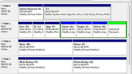

This is how I have my PC setup..... drive wise.
First one is an SSD Boot drive, the rest are all WD black 2TB drives...
I also run 2 2TB external E-Sata drives for backup... switch them out every other week.
Oh Wow! May I ask why you split drives up like that? I used to do it back in the day of FAT32 which suffered heavily from fragmentation issues on the drive but these days to me it makes more sense to use folders. Actually quite the opposite. I've taken a drive and rather than adding the partition to my system as a logical disk I've mounted the partition into an NTFS folder so C: is my SSD, and D: is all my other drives.
The only downside I could see to partitioning like that is dead space (not an issue unless your run your computer at the storage limit like I do, which reminds me I need to purge some old files again, :( )
Probably habit from years and years ago... more than anything. I like to be able to just specify a drive letter when backing up also. I don't run any of the drives anywhere near full... and have room to extend if needed on the smaller partitions...
