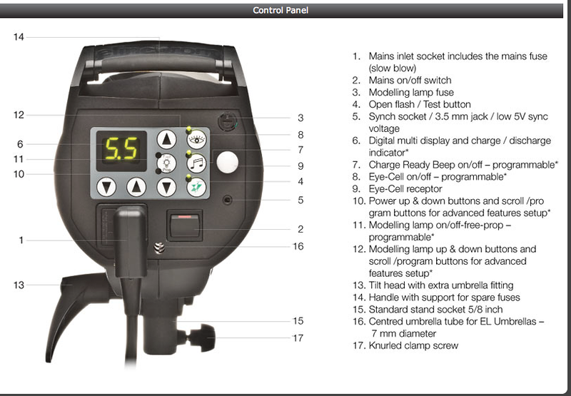

For for Sekonic, for metering/meauring the output of your light(s) at your subject (or even background) you will plug the cable (that comes with the Sekonic) from the meter into the port on the back of your (main or light that is most convenient for you to attach it to...the cable is pretty long).

But you won't ba able to fire all the lights with your Sekonic, right? All your lights will fire. The Sekonic triggers the light it is attached to by virtue of the cable connection so it is firing the light it is connected to. The other lights that are set to be 'on' for your shoot are fired as a result of their slave capabilites.
The Sekonic is only plugged into one of them, say, the main light. Yes, correct.
What if I want to take a reading of the background or kicker light? If you want to take a reading at your BG, you place the meter at the BG and face it at the camera and fire...you could do the same at various points of your BG so you can measure for even-ness if that is what you want to achive (for example) . If you want to measure the level of light on your subject , to determine or confirm lighting ratios, face the meter at the light you want to measure, and turn the dial on the meter dome so it isolates that light for meaure. This you have to tweak light by light and overall while you are setting up.
Do I need to unplug the Sekonic and plug it into the other lights, one by one? No, as descibed above you plug the Sekonic in the one light and the rest fire as well as long as they are slave 'on'.
I do know that I can set these lights to "optical slave" - was this what you meant? The lights can be set to optical slave and will need to be for metering since the shutter button on your camera is what triggers the transmitter atop your camera to fire the lights. For metering/measuring, the Sekonic is firing the light its cabled to and the slaves are reacting to that fire. See item #9 in the diagram for the eye on these lights. So at the camera the shutter puts the Skyports in charge of the fire of all the lights (assuming all built in Skyport receivers), and at the meter, the Sekonic puts one light in charge of firing with the slaves following to fire the rest.
Do they act like optical slaves automatically? Yes if you have the switch for the eye set to on.
