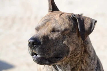

Here is a picture strait out of my camera.
When i try to use the url it keeps saying invalid file.
It is combination of both skill and equipment. This does not mean your gear is poor. I myself have the same camera lens. And you have shown that you can take sharp photos. Of course better lens can help such as a prime. I will not pretend to be an expert but do follow the advice given above, do more research on photography and maybe perhaps in the future and when budget permits get additional glass.

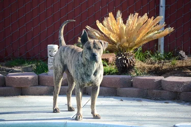

Can any one tell me what went wrong with this and also thanks everyone for helping me get better. you guys are awesome.
When you are taking a photograph while handholding the camera don't jab the shutter. Gently half press to get focus and meter reading and then let out half a breath and roll your finger gently down for the shutter release. Hold your camera up to your eye and rest it against your forehead a bit, have your left palm supporting the camera body and your left fingers working the lens. Your left elbow should be jammed solid against your chest. Your feet should be about shoulder width apart with your left foot slightly forward and supporting a bit more than half your weight.
Good camera technique will improve your keeper rate.
Again I am not claiming to be an expert but IMO the plant and the small both grab attention from your dog. I would experiment with the composition, adjust focus on the desired subject and adjust aperture to a shalllower DoF to get the best possible shot which IMO would be your dog being the focus of attention and against a slightly blurred background. There may be limitations to the shallower DoF from the 18-55mm as that is due to the nature of the lens. So do not be afraid to experiment and it's not as if you are shooting with film which can be rather expensive. More exprerienced users can provide better suggestions, comments and techniques. But that's just my take.

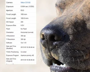

First shot: As Lew wrote; it looks sharp as it is, however you shot that at focal length of 160mm, and the shutter speed was only 1/250. So you're pushing your ability to hand-hold at that focal length.
Another thought; do you have any auxiliary lenses or filters on the front? Sometimes a UV filter is affecting the sharpness.
I am a poor judge of focus in posted images, but it could be that your camera was focusing on the wall blocks or the fence, or the figurine attached to the dog's butt. When you have a cluttered background, and can't improve the composition, notice where the camera is trying to focus, and either change the focus point or lock focus before tripping the shutter.
I use to use uv filters but found that they actually hurt image quality so I no longer use them. I also only shoot in jpeg not Nef. I have been wanting to switch over but am not exactly sure how because of memory and conversions. I feel like like raw or nef would help having better pictures.
