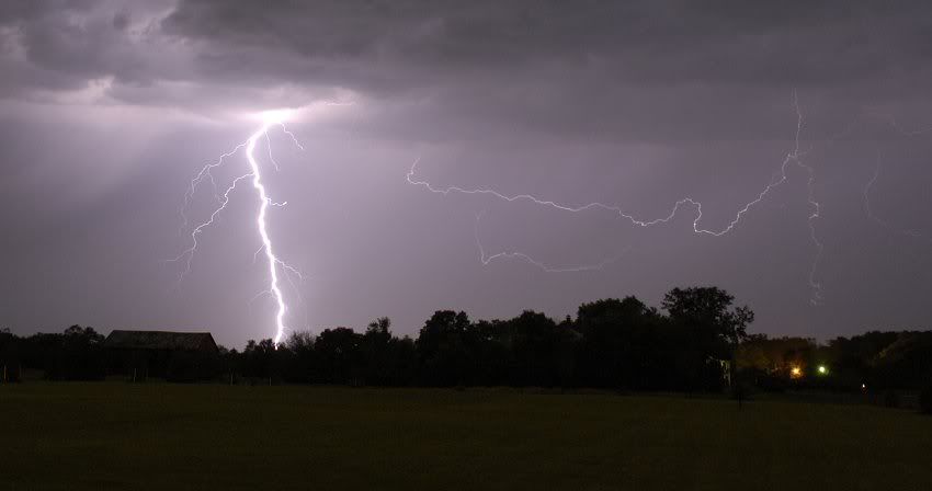

You want to use a long shutter speed for lightning. By long I mean... 30 seconds or more even. You get a correct exposure by using a small aperture, like f/18 or f/22. I'm not sure what camera you're using, but most point and shoot and hybrid cameras can't do extended exposures (my fuji was limited to 8 seconds). Then you want to manually focus to infinity and hope to capture something while the shutter's open.
My lightning recipe:
Tripod
Wide angle
Buildings or other elements to juxtapose the lightning with/against
Long shutter (usually 30 seconds, depending on how dark it is out)
Tight aperture
Focus set to infinity and locked down
Lots of frames - most will be throwaways - once in a while, you get a 'keeper':

x2, just do what he said and sooner or later you'll get some good pics. also you can look on flickr at lightning pictures or anything else for that matter and sometimes it will show you all the settings that were used when taking the picture.

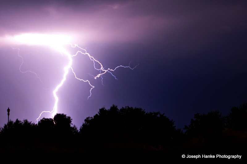

Wow! One of the best-looking Lightning pictures I've ever seen!
Thank you kindly!
I'm guessing this was shot in RAW and then the WB was edited in post? Amazing coloring and light!
Yes, I always shoot RAW. The WB needed very little adjustment. Note the light inside the house and the tail lights going down the road during the exposure - they're fairly accurate, I think.
The clouds themselves were already pretty cool looking straight out of the camera, but I did apply some burning to them using an overlay blend mode, which really brought them to life. Then I applied a graduated cooling filter to the top of them to give the composition as a whole a more intriguing color palette.
