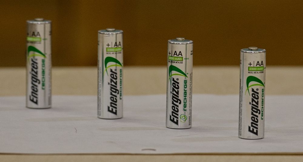

Confirm that it is the lens and not your technique. Check your focus settings and when focusing, make sure there is light and dark areas in the focus box.

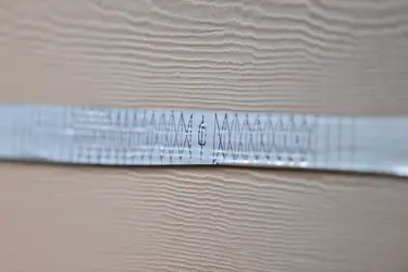

You can check for front/back focusing by laying out a tape measure and focusing on one of the dark "foot" markings.
Or something like this...
Cheers, Don[/QUOTE]
THIS AF fine tune target works GREAT for me...a bonus is that this duct tape has little patterned dots in it. I bought the roll of tape at Home Depot, like a year ago. Here are some of my test shot fine tune center crops from SOOC JPEGs made at 3,024x pixels.
105 AF-DC NIKKOR AT F:2.8 CROP.webp
105 AF-D DC Nikkor tested at f/2.8, focused right on the center "O" target.
Here is the center crop for the 300mm f/4 AF-S Nikkor, wide-open at f/4. Focus is dead-in...but as you can see, the 4-inch mark behind the focused upon spot at "O" is "out"...
I am shooting at an angle of oh, 30 degrees maybe, to the wall.
Below,on the right, is the link to a 3,024x full-frame shot from the 300mm f/4 AF-S Nikkor lens, with the full run of my focus target shown, so you can see the DOF effect better (file is named D3X_7775-copy_300-f4_afs-nikkor-jpg):
