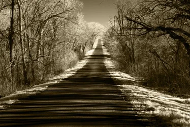

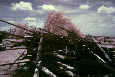

OP These are two test images I shot with my IR conversion camera when I first got it back after the conversion. I was shooting images so I would have something to play with in post so I had an idea of what to do. As you can see the IR color image actually has blue skies , If you really want to play with IR get a lens filter for your SLR. you will get much better results , if you like it then you can find a cheap used DSLR and pay for the conversion which has come down a lot in price. Last I looked life pixel was doing conversions for a hair under $300 where they used to be $400 or more. I have learned from owning an IR Camera that you will absolutely get your best results using the lowest ISO setting on the camera and a tripod.
Anyway thats my 2 cents. Have fun experimenting.
