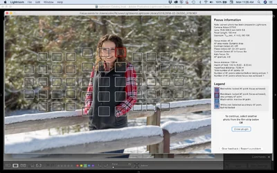

The first thing to check is your active focus area. I attempted to see it on my software, but your focus areas did not show up for me. I'm not sure why not, but you should be able to check in your camera's LCD. Turn on the indicators, and you will see a bunch of yellow ones and one red one.

Looks like I found one of my errors. My focus got set to AF-A vs AF-C, which is what I normally use.
