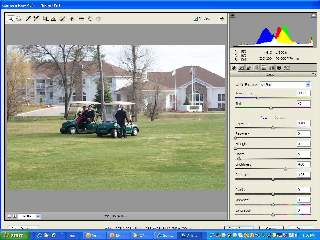

There is more that can be post processed with a .nef/Raw File. Here is a screen shot of a .nef/Raw file that I opened up in CS3. This is the 1st screen that comes up. you can see you have a lot of options you can change compared to JPG. I have fallen in love with RAW since I got Photoshop CS3. I wonder if that mean my images suck cause I have to rely on it. :-)
