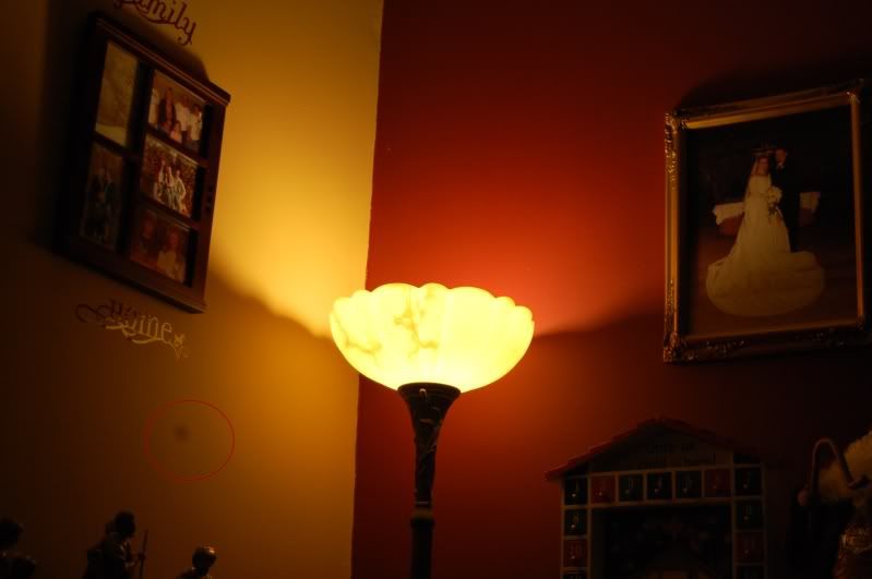

here some pictures. red circles around the spec. i see it in the viewfinder also though
but its not blurred in the viewfinder. its a small black spec when i look through the viewfinder
If you can see it in the viewfinder, and it shows up in pictures - it has to be on the lens.

its a dark spec like those when i look through the viewfinder. but blurred on pictures
Those circled spots ARE sensor dust. At small f/stops like f/11,f/16, and f/22 the biobs are very small and tiny. At larger apertures like f/5.6 and in that range, the blobs are larger and less sharply-edged. The gift unwrapping shots--those ARE sensor dust spots.
Art wide apertures like f/1.4 to f/3.5, the blobs are very diffuse,and actually kind of hard to see. The smaller the hole you shoot through, the smaller and clearer and sharper-edged the dust on the sensor's AA filter array is.
