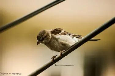

Guys, need a little help here.. It seems the sensor somehow has a hair on it.. It's visible clearly in all the shots now, I set the shutter to 30 secs and could clearly see it on the sensor and it seems to be easily removable. Lew did send me some something called a "14mm and a 18mm sensor swipe", but I don't have a clue how to use it. I was hoping to take it out tomorrow, anyone? :(
It can be seen in the last image I posted, and also this one I took later (on the wire near the feet):
I've looked til my eyes hurt, and I cannot see it. You sure you're not looking at his back claw, curling around under the wire?

I don't see it either but if it is there cleaning a hair should not require a full swab cleaning. I would just lock up the mirror and why holding camera lens mount downward while blasting it with a rocket Blower it should blast the hair off.
First just use a rocket blower and give it a blow. I would only try to do the liquid cleaning if the blower at first doesn't work. Something like a hair though should come off pretty easy with a simple few blows. If you don't have a camera blower, you can get an ear bulb from a pharmacy really cheap that works exactly the same. Its what I use actually.
Here's the hair:
