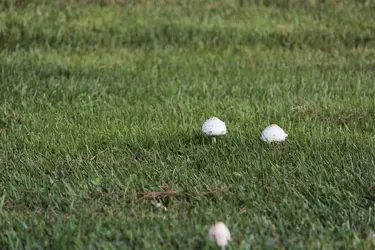

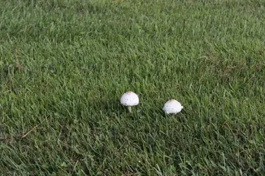

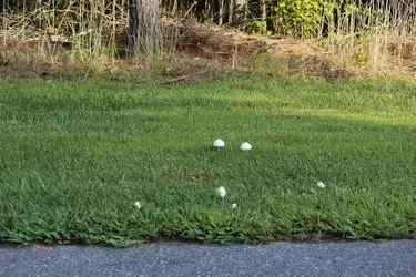

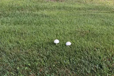

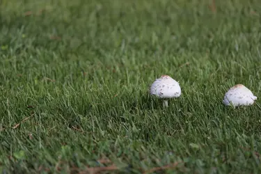

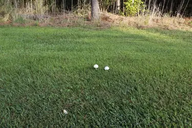

Are you shooting on a tripod? Are you using the center AF point? If you ARE using liveview at 10x, you should have the lens AF set to OFF, so that after you acquire the focus manually, it doesn't re-focus on something else. As well, with the camera on a tripod, there is less chance of either camera shake, or focus drift to be a problem.
If you have used the camera on a sturdy tripod, AF off, IS off, manual focus using live-view at 10x, shutter triggered either by remote or by 2-second delay, and you still get softness, then it could be the lens. But you have to make sure all the other possible causes have been accounted for and ruled out.
How do you know you are getting softness? Are there parts of the image that are sharper than the point you are focusing on, or are you using another criteria for determining softness?

I will do some test shooting with my current settings this weekend and post a few examples.
I will only pose ones that were on a tripod.
All on tripod, manual focus with 10X live view.
1 $_MG_3837.webp 1/125 f/5.6 iso 100 55mm on 18-55is
2$_MG_3836.webp 1/180 f/4.5 iso 100 34mm on 18-55is
3$_MG_3835.webp 1/250 f3.5 iso 100 18mm on 18-55is
4$_MG_3834.webp 1/180 f/5.6 iso 100 250mm on 55-250is
5$_MG_3833.webp 1/250 f/4.5 iso 100 135mm on 55-250is
6$_MG_3832.webp 1/250 f/4 iso 100 55mm on 55-250is
