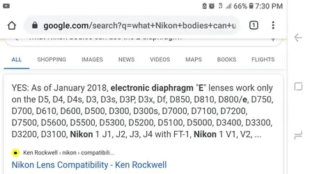

If the lens has an inbuilt focusing motor, then it will work on the D5200. The 5200 can also use the E diaphragm.
