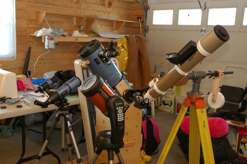

PS: I'm not talking through my hat. I have telescopes from 8 inch newts down to 3 inch achromats. A 6 inch cat for planetary, a 6 inch refractor for nebulas, a 4 inch apochromatic for doubles and planets. I really like refractors but I started with a newtonian. I have a variety of mounts from a home made dob to fully a computerized large capacity equatorial.

If you want to spend your budget on the scope you can build an altitude mount yourself if you are the least bit handy. Google 'd i y astronomy' or 'telescope pipe mount'. I made a pipe mount for 'kicks', cost less than $50 and works a charm. I use it for visual star hopping. I also built a dob mount for my 8 inch newt with 1/2 sheet of plywood and a few bit of hardware and a couple of old lp's.
