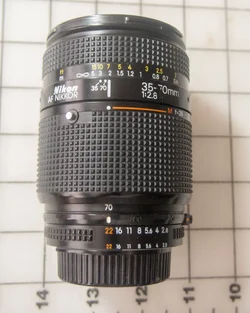

0ptics, if you are thinking "budget minded", and still want to keep with getting a nikkor lens, you might also consider the 35-70 f/2.8 AF.
ive had this one for many many years and it is still a great performer. its a push/pull lens, but that doesn't bother me too much.
great optics, and the AF is pretty snappy. (you need a camera with a focus motor though) its an older pro lens that can easily be had for <$400.
