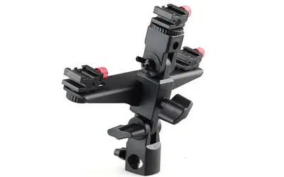

i want to fix the problem of the apollo softbox tilit.
can i connect my tri-flash mount :
to this regualr umbrella mount ?
its possible - do you think that it will work ?
light stand ---> regular umrella mount---> triflash mount + 3 flashes and softbox.
thank you !
Can't see any reason why it shouldn't work - a spigot is a spigot is a spigot, BUT the one concern that I do have is that the rig might be a little heavy and start to droop. Out of curiosity, why do you want two swivels?
because i cant tilt my softbox (70x70) to 45 degrees.
i really dont like to use boom stand especially in outdoors.
any other solution or take a risk with the two swivels ?

by the way i found this swivel :
http://www.manfrotto.us/swivel-umbrella-adapter-lite-tite
his max Load Capacity is 5.51lbs=2.5KG.
my gear weight is:
triflash bracket=330g
nikon sb600=300g
x2 yongnuo 560ii=700g
softbox=450g
x3 rf603=192g (included batteries)
12 AA batteries for the flashes=288g
the total is = 2.26KG.
what do you think about the swivel of manfrotto ?
Can be fine or is it still risky ?
thanks again

Put this Manfrotto 026 Swivel Umbrella Adapter (Lite-Tite) 026 B&H Photo on the stand and mount your flash mount on top of that.
I don't know that you'd get 45 degrees though. You'd need to get a 5/8" X 12" or 14" piece of iron gas/water pipe from a hardware store and another manfrotto adapter to extend the umbrella out enough for that.
but i must to use two swivels if i really want to tilt my softbox to 45 degrees.
i need to put the manfrotto 026 on the light stand and then mounet the triflsh on it..
tirediron any idea ?
