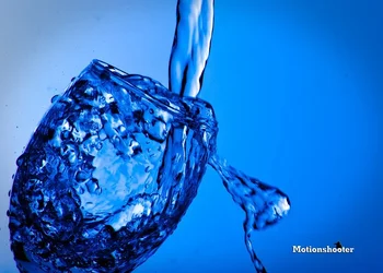

So I tried my shots again with the wine glass and water and am still not satisfied with the results. Wondering if anyone can chime in on how I can get more of the splashed water in focus.
This shot is with a similar set up as the previous water drop photo: ISO200, F/40, 1/250 at 250mm. Camera is about 4 feet from subject with manual focus on middle of glass. I used a cable shutter release to reduce camera shake and of course, set on a tripod. One strobe was used and aimed at reflective white backdrop and bounced onto the water.
So the glass itself is in focus, but I am wanting more of the water in focus. From the depth of field calculator, I should have about 2 inches of DOF but do not seem to be actually getting that. Any suggestions?
