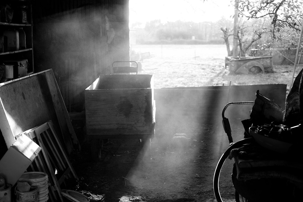

Stir up the dust to make an authentic and interesting atmosphere, preferably with some backlighting from the sun:
If it has wooden planks on the outside look for rays of light coming through the gaps, a reflector and tripod will help
