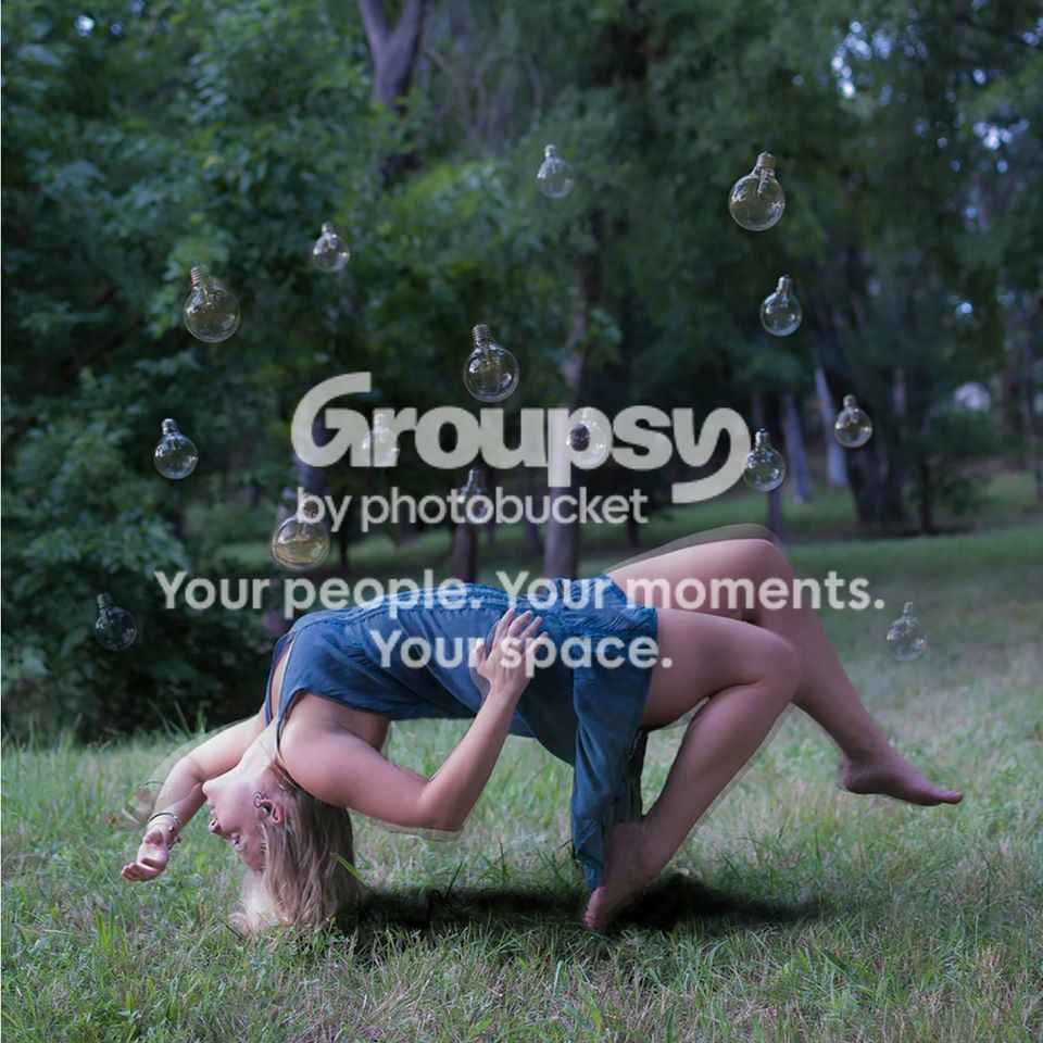

I have been working on a short series of photos and my recent shoot did not go well. To me there is nothing dynamic about the photo or angle and I would like to reshoot with some fresh ideas on how to approach this. I wanted the image to be dark, black and white and in the woods for a fantasy feel. I have two strobes that can be used as well to help control/cut the ambient light. The girl in the photo is the one who took the time to PP the photo just because she liked it but I know I can do better. Anyone have any ideas on how to approach this?
Is her movement intentional? I would definitely flash up some strobe power and knock the background down by at least two stops. I would probably move about 30 degrees left for my shooting position, and light her with a large gridded BD as key from 90 degrees [current] camera left, and a large very low output SB right on [current] camera axis. I would also look for a level patch of ground; I can see the image is level based on the tree trunks, but because the ground is sloping, it's a little irritating to the eye (my eye at least). I also think the pattern & number of bulbs needs to be tweaked; a more even, 'rain-like' pattern I think would work better.
The movement of the legs particularly almost looks like a double image instead of movement. And the position seems a bit awkward, to me it looks like she's trying to balance on whatever she was on, maybe think about how to position her so she doesn't have to try too hard to balance.
I like the idea of B&W and the bubble-like clear light bulbs dropping from the sky although I'd think about if you want those to continue to the top of the photo or as John said how you want the pattern. I think all the green, the blue of the dress, and her skintone for the most part will make for a lot of gray. I'd think about the time of day, and where you want her against the trees (and agree it might be better not on a slope). There is a little dark and light but not much in the trees that are viewable and more of that might translate better into black and white. (And watch the tree growing out of the subject, it's not bad but somewhat coming up out of her middle.)
I'd think too about what she's wearing (cute dress! works for fun/casual but not sure about it in B&W). With her somewhat light skin and light hair do you want her in white or a light color to highlight her against the background? or in a dark color or black to have contrast herself against her light skin/hair?
Cool idea, glad she liked it.

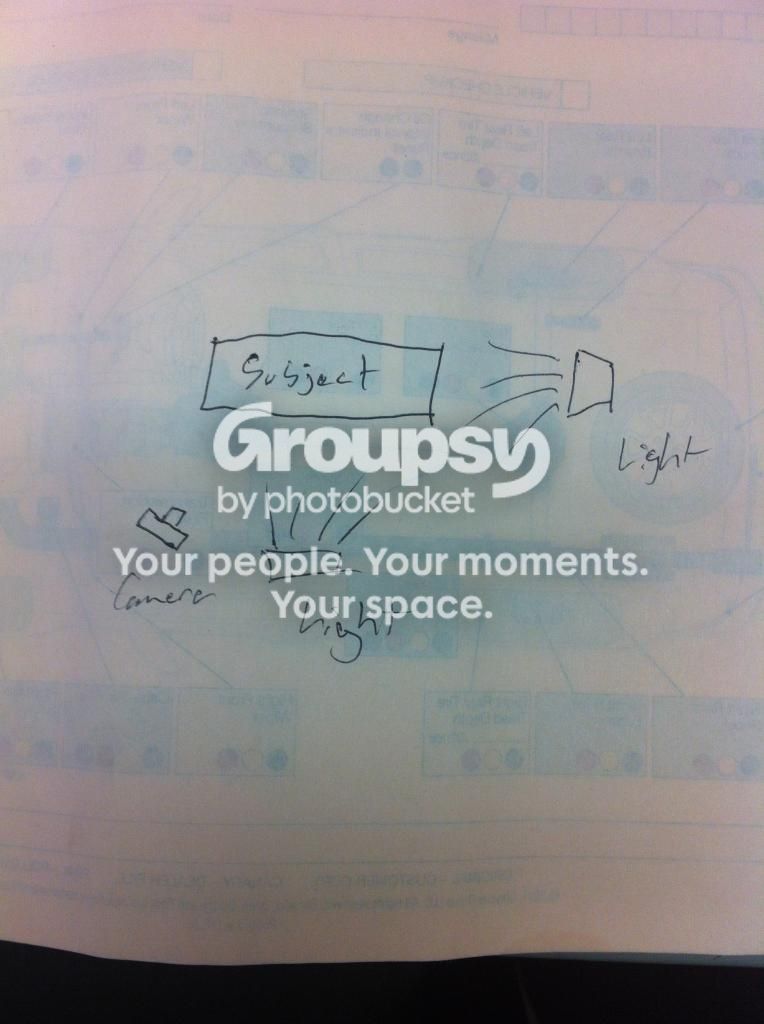

so if I understand you correctly the set up should be similar to this:
I'd have the key on the opposite "end" that is, illuminating her face and torso, and using the grid to force fall off toward the legs. Notsure if the results will be what you want, but when I use my cranial image simulation software, that seems to produce a good looking image.

It wasn't bad at all for a practice shoot, seemed like it was fun and she liked it (and may not have realized what you had in mind, she might have thought boho chic not ethereal etc.).
I like the idea of white, flowing (to me nude would be a lot of skin! with this type pose anyway unless you figured out how to drape something, but I can't quite picture that looking believable) - maybe white but semi-sheer? With a long flowing dress maybe it would cover whatever the model balances on to give an illusion of floating, to me the floating midair is so obviously photoshopped it can get hokey, makes me think of a magician's trick.
Have fun with it, seems like the end result could be pretty cool.
I am a bit worried about the floating looking too fake as well. I had her do a couple different poses to get as natural of a look as I could but she was struggling a little with core strength to hold herself up a bit along with her legs. She did great though and was very helpful. Thinking through some of this and something else going on earlier today allowed me to come up with the next photo in the series as well. Wont be anywhere near as difficult as this one so it may get done first but as I work on this I will for sure update with the work for some feed back.
