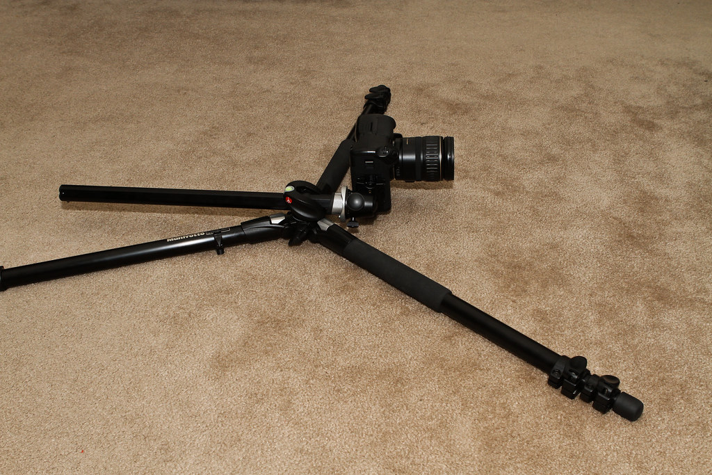

The 190 and 055 are essentially the same, just different sizes. I have had no stability issues with the center column and you can go horizontal with it to get it out of the way.
IMG_5929 by Ingerson"PCD", on Flickr
It does? Is that in the box or do you order that separately? I'm not seeing that option on B & H and it sounds like something I'd like to look into.
It's in the box, well actually it's stuck in the bottom of the center column. It has as little snap ring that holds it in the bottom of the regular center column when not in use.
As EIngerson shows above, the 190 and his 055 will get very low to the ground ;)

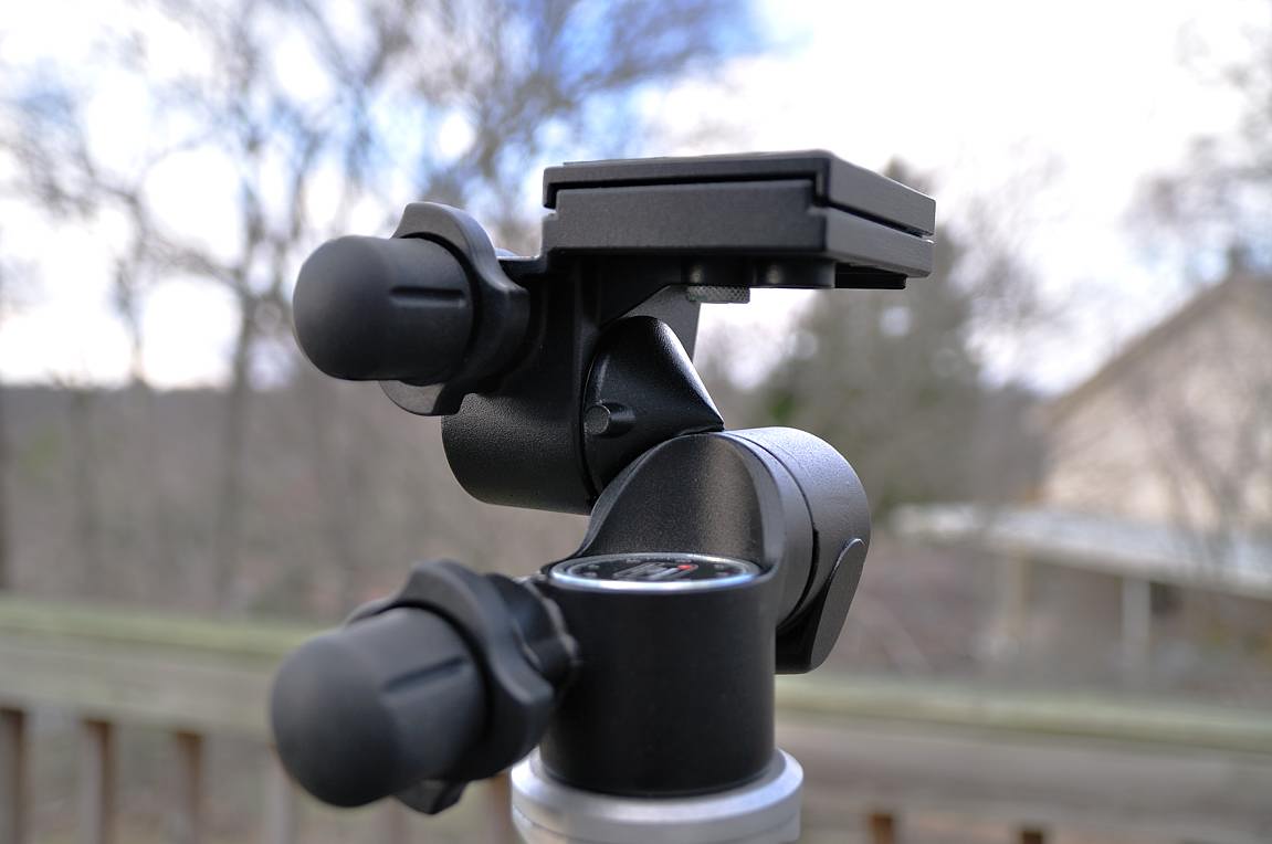

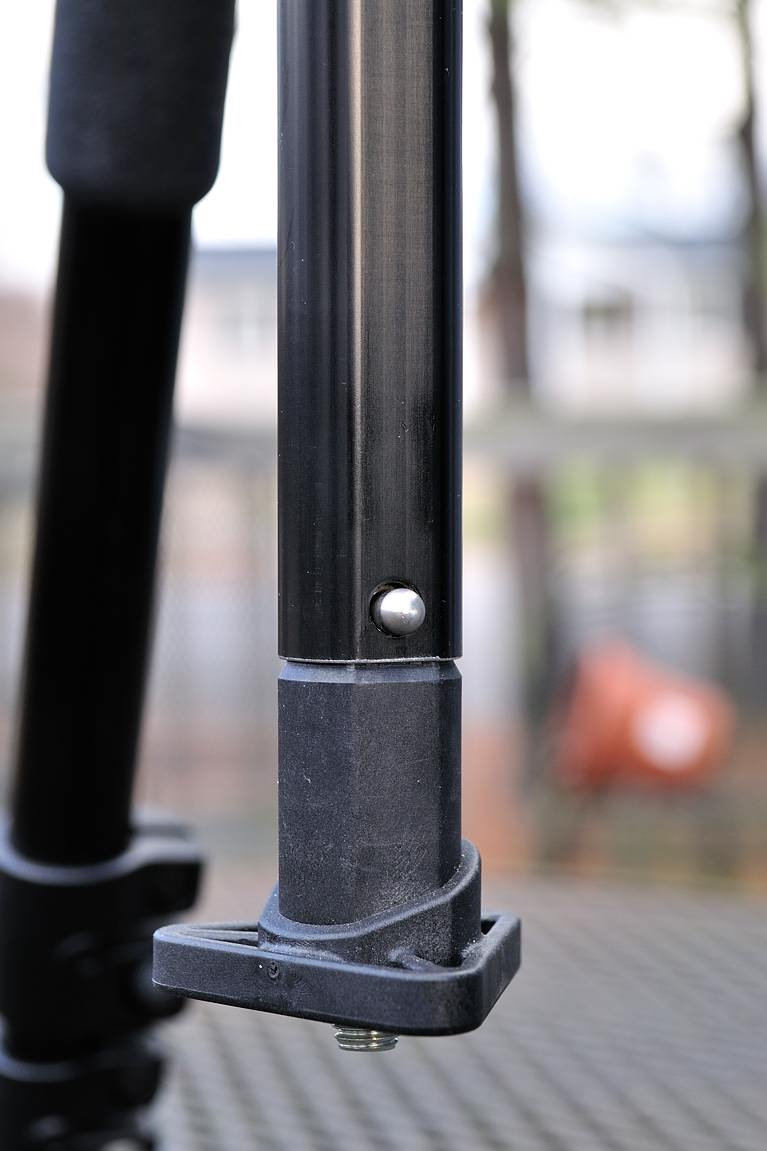

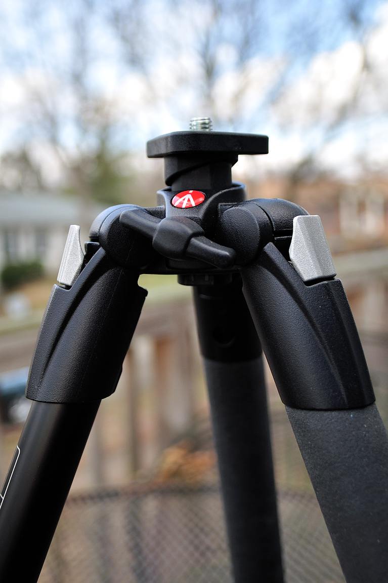

Edit ... Pix, and I apologize for the depth of field. It's just above freezing here in Tennessee, the wind is blowing with 35mph gusts, I'm wearing a t-shirt, and like a complete idiot I went outside to shoot these without a coat. By the time I got to about the second one I had completely forgotten everything I knew about photography ;)
Photo 1 - Shows the short column stored in the bottom of the center column.
Photo 2 - Shows the short column replacing the center column.
Photo 3 - Just because it was already installed, this is the Manfrotto 410 "Mini" geared head

Just to add that the newer 055XPROB series tripod legs (and newer 190 series ones) of which you can see one in EIngerson last post, can't use the low angle head adaptors since the block that secures the tripod head (that you can see in the middle of the legs in that picture holding the column in its horizontal angle) is a perminant fixed feature of the legs
