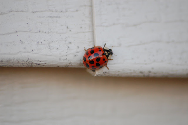

I'm trying to learn macro photog, but don't know where to start. I guess my biggest question is how are you able to get the subject to fill the frame? Is it done was cropping the picture? I tried it last night with a lady bug, using my Sigma 70-300. I zoomed the lens past 200, turned the macro feature on and shot the picture. I was maybe 3 feet away from it.
Here are the results.
Pre-cropped picture

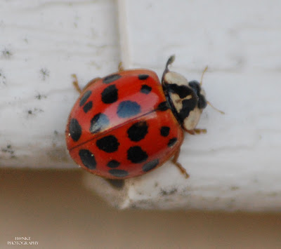

Cropped Picture:

nope that is as close as the siggy will go - its not a true macro lens - more of a close focusing telezoom. Its ratio is 2:1 - whilst real macro lenses are 1:1 - ergo your not going to be able to fill the frame with a tiny bug.
The sigma is much more suited to things like flower heads and larger subjects where you can fill the frame with them - and infact on a tripod it does flower photography really well (I rate it as this lenses strongest point),
If you want to get closer then your going to have to look at a better maro lens - the nikon 105mm macro, sigma 70mm, 105mm, 150mm or 180mm macro - all primes - these are full 1:1 macro lenses.
I would recomend going for something of 100mm or greater for insects so that you get a longer working distance - the sigma you have has a very long working distance (which you will have noticed).
As for working in macro make sure your focusing in manual mode - and if shooting try setting the focus to max magnification on a lens and then moving the camera and lens back and fourth to acquire focus.
