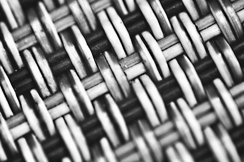

So I got some cheap extension tubes that I've been playing with, mainly using all 49mm of tubes and a 135mm 2.8, I've been able to get shots like this from a reasonable distance
But I was wondering what would happen if I got a reversing ring and put a 50mm on the front of the 135, what would the magnification be like compared to this?

haha I love the length of the 135 with tubes, but I tried just taping my 50d to the front and yeah it was a little too much haha, had to be way too close. this is a shot of a chair with it haha
