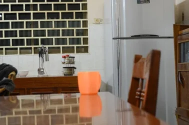

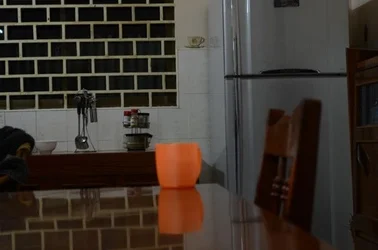

Underexposure with kit lens when shot through viewfinder

Ok, sir. Look at the exif data I posted. 02.jpg is in Live View. Shutter speed is 1/4, which is slower than 1/6.
you also have slightly different framing between the two shots... there is more junk in the frame on the second image... and with Pattern metering, that could be enough to cause the difference. The different framing tells me the camera was moved, and who know what else changed (if the camera was on a Tripod, WHY did the framing change?).

Throughout these replies I have been testing it on a tripod without moving the camera at all. In the example I posted first I was holding the camera. However, in the 10 tests or so that I have done since, it has been on a tripod with the exact same frame. Testing has been indoors under artificial light. I also have been testing only with spot metering as well. This is starting to seem obvious that this is not common. I would be happy to post another test with camera on a tripod.

Ok, here is a test following pgriz suggestion. I took 4 photos, all of which were done on a tripod. I took two shots in the viewfinder (one manual with 0 on the meter, and one with aperture priority), and two in the live view (one manual with 0 on the meter, and one with aperture priority). As you can see the frame is the same in all. The metering method is the same in all.
Viewfinder | Manual | 10/16 | f6.3 | ISO100 | Note: I zeroed the meter manually.
Viewfinder | Aperture Priority | 10/16 | f6.3 | ISO100
Live View | Manual | 2" | f6.3 | ISO100 | Note: I zeroed the meter manually.
Live View | Aperture Priority | 2" | f6.3 | ISO100
So, as you can see, the Live View seems to just arbitrarily increase the exposure, unless there is some way to adjust this. I don't know. But, as pgriz said, it does seem to be metering correctly.
