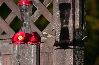

Using Flash to Freeze Action - fail
Oct 2, 2008
7,218
3,078
Vancouver Island
SS-1/250, F11, ISO200
SB-800 off camera full power approx. 30degrees left 15 ft from subject, in remote.
On camera flash set to Commander.
Obviously flash needed to be closer to subject. But what needs to happen to freeze motion?
There is still motion blur in the wings, which is what I'm trying to stop. I can't get high enough SS without sacrificing high ISO noise.
I'm curious about this. Was this also in full day light?
As in the flash flashes but with the slower 1/125th shutter it's not fast enough to completely stop the wings (need something higher but flash not compatible?).
You can see through the wings as if it was a partial exposure. So I'm guessing the wing was lit by the flash, but the wing then moved back and gave it the see - through look.
Is this one of those instances where you need shutter of 1/2000 to completely stop the wings in motion or less ambient light ? .. ahh . blur/ghosting of the wings is discussed here
Secrets of Digital Bird Photography
You need to use a lot LESS flash power. At 1/1, flash duration is just a hair over 1/1000 second. If you can get it down to 1/16 or less, you'll be in the ballpark. You'll have to sacrifice depth of field by opening up several stops of aperture, but it's either that or increase ISO. SB800 flash duration chart:
On camera flash set to Commander. Obviously flash needed to be closer to subject. But what needs to happen to freeze motion?
You need a much, much slower-wing-flappin' birdie....something like a robin or black capped chicadee's wings wouldda' been frozen--but thoe birds cannot hover like bees!!!!.The problem is that full-power flash is as flash goes, slooooooooooooow. It might be 1/800. Or 1/1000. But a hummingbird's wings move very,very very fast. The little bastids have wingbeats that are insect-like in terms of rate of speed. Big slow birds have like two-, to say four-beats per second, maybe even six beats per second wing speed.
If the flash were set to an AUTO-mode, and placed much closer, you could get a faster flash pop...say one of 1/5000 to 1/20,000 second duration. The so-called fractional-power speeds of flash are VERY short....but a full-power, full capacitor dump flash is usually only around 1/1100 second with an SB 800 class flash.
And also, I think you are VERY CLOSE to a 50/50 ambient + flash ratio here:
At ISO 200, Sunny 16 Guideline says f/16 at 1/200 second is the right daylight exposure. Wellllllll.... f/11 at 1/250 is pretty close to that in this kind of late-afternoon, slanting sunlight, or early AM low sun...which is what makes that freaking AWESOME! shadow of the feeder. SO, I think part of the blur on the wings is the AMBIENT portion of the exposure.
Artistically, I LIKE a little bit of blur or ambient on hummingbird wings...this shot has a lot going for it. LOVE the shadow!!!
But if you want true STOP-MOTION wings, you need to get the flash 3,4,5 feet away at 1/4 to 1/8 power and keep the ISO level LOW, so as to avoid getting any "ghosting". I personally think the wings here show a teeny bit of ghosting from the ambient, and the flash stops "most" of the gross movement. I kind of like it, but I know what you are thinking.

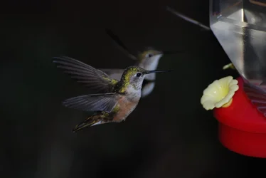

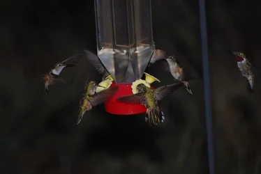

Here are a couple of pictures I took (not sure on the exact specs), but I was able to get a lot closer using my 300mm lens and my flash.

As said by others if your ambient light is not contributing to the photo then you can freeze motion with the flash; this is how a lot of macro photography is done. When I'm shooting at 1/200sec ISO 100 f13 the ambient light is typically not powerful enough to provide much to the exposure so the flash is giving nearly all the lighting. For something as fast as this you need a very short flash duration - if need be add a couple of more flash units so that you can combine their output.
Remember don't use high-speed sync for this - highspeed sync makes the flash send out a series of light pulses which for something like this wouldn't be ideal unless you wanted a series of positions of the wing to be shown instead of a single sharp wing position.
Thanks all. I think John nailed it .I didn't realize that the duration of the SB-800 at full power was 1/800sec. I will half the distance from flash to subject and try 1/2 and 1/4 power, hopefully this evening. As for ambient light, you can sort of see that by looking beyond the fence. And aperture will be f 6.3 wide open.
