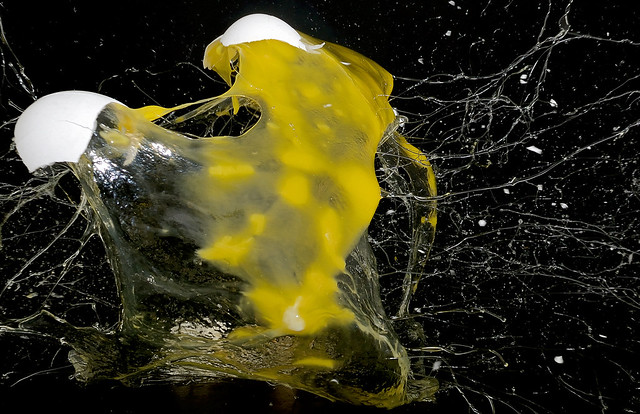

Here's a hint....... Traditionally you need light to record an image on film or a digital sensor.
If the only source of light is a 1/10,000 the of a second burst of light, it doesn't matter how long the shutter is open, the sensor will only record that 1/10,000th of a second moment in time.
I recorded this in a dark room. I set up the shot, got my exposure, focusing, etc. Then the following.
Turned off the light.....
opened the shutter on the "Bulb" setting.....
simultaneouslike shot the egg with a pellet gun and fired off the off camera flash.
closed the shutter
turned off the lights.
The shutter was open for over 6 seconds, but only that tiny slice of time that the flash fired was recorded on the sensor since it was the only source of light.

Did you use an audio trigger for that? Or just really good timing...?
Really good timing. Haven't been able to justify the purchase of an audio trigger yet, and don't have the technical knowitallitude to make my own.
On the short list though, for sure. Even have a "studio" space in the basement for all kinds of high speed shenanigans.
