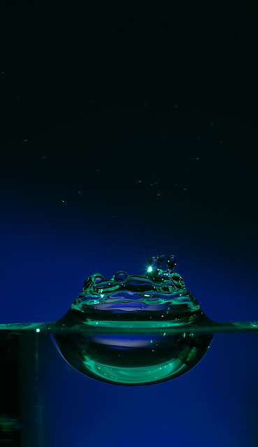

I took this with two speedlights, very little ambient light and a shutter time of 1/60th of a second. Without the flash (and with sufficient ambient lighting) at 1/60th of a second the water droplet would just be a blur. The flash effectively gave me a much better vehicle to "freeze time" and get the action I wanted.

Exposure time for this one was 6.1 seconds. I'll let you see if you can guess how I did it. ;)

If you were in complete darkness, the shutter could stay open forever and you would never get an image. Whatever the flash duration is effectively becomes your shutter speed. 1/4000th would not be able to freeze action like you see in Strad's photos, but 1/50000th sure as hell can.
