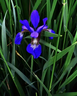

Very blue iris for review
Ernicus
May 18, 2012
2,689
337
Old Town, ME
I did not adjust levels much, certainly not enough to make such saturation. I even lowered the saturation a bit as the grass is not as green as before, but the blue on this one just radiates. If I desaturate more it gets ugly.
Is this just a cool flower? a trick on the eye by the green on blue? or is there something else I can do to it?
There was a few growing out of the middle of this very tall grass, I didn't pick and stick it there. ;-)
thanks

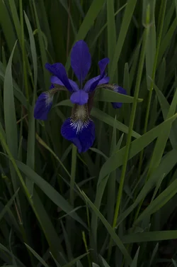

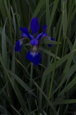

Here is the raw file "as shot" and raw file using "auto"
so I guess the in camera jpg conversion added that extra saturation and vibrancy. Thanks for asking the questions, made me think to look at the raw file...wasn't even thinking.
OK -- then the next question becomes how are you processing the Raw file. The intense colors of flowers, especially colors that are on the extreme edges of the color space give camera JPEG engines fits. Basically they go into seizures, flail around on the floor and then output garbage. I created this illustration for an earlier thread where someone was having the same problem. I took this photo. On the left you see the camera processed JPEG and on the right you see my conversion from the Raw capture. The camera software just couldn't do it; it had a seizure. This is precisely what's happening with your iris.
The exposure is excellent and the Raw capture had all the info necessary to produce a good photo. The automated software just couldn't handle it.
