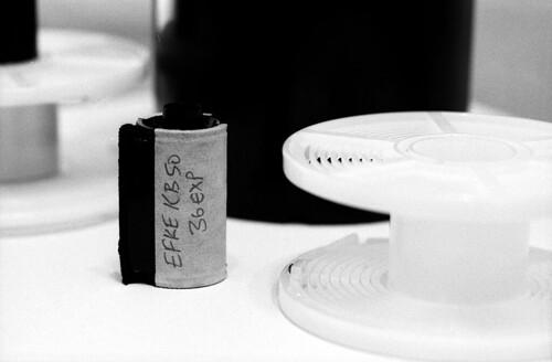

Like so:
My first developing error? I used the right amount of developer to process a roll of film loaded on the bottom reel. The problem? I'd put the loaded reel on the top. Good times.
