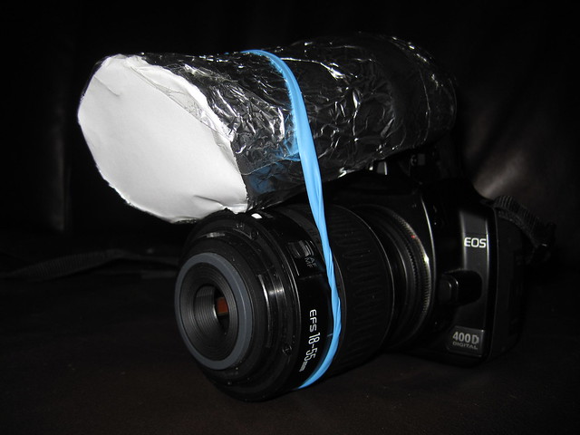

I'm messing with macro photography, bugs and so on, but I don't have a dedicated macro lens. Someone said I would have trouble with light, as I reverse a lens on my 400d body which cuts down on the light.
So, I figured I'd try to get light down in front of the lens, where it's needed. I'm sure many folks have done similar, but I thought I'd have a go at this...a water bottle, a piece cut so it holds itself in the flash hot shoe, white printer paper on the front, and silver baking foil all around. The end is cut on a slant to allow the light to go down in front of the lens.
Question: You think it'll work?

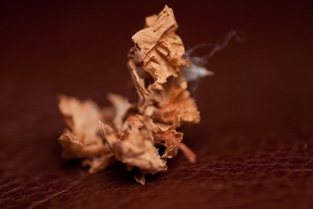

Well, in the absence of a suitable bug, I found a dried petal and took it's photo.
You think the light looks birght enough, and smooth and even? BTW, no PP - just imported from RAW and JPeggified.
I think the light looks pretty dam$$d good,actually.

Edit I think the photo looks very cool! The lighting looks great to me.
Looks like its throwing nice, soft light. It will be more narrow than a softbox. But the quality of light looks good. :thumbup:
Nice DIY solution, especially in combination with the reversed lens. Light looks good.
I'm a fan of DIY solutions myself: Buck

I think you need to rig up a 2mm reflector to throw some fill into the shadows. Nah... Jk. Looks good. Thanks for the chuckle on your home made snoot. I love the way it looks on top of the camera. You could try wax paper as it is closer to diffusion paper than what you have on there.
I'm impressed. The most home made mod I have done is tape a piece of paper to my wife's pop up flash to create a bounce card.
I use something similar. Only I put the foil on the inside and duct tape on the outside. I also use a paper towel for diffusion instead of printer paper.
Thanks everyone...now I know it works, I will get on with the deluxe version. I think I need one which has a reflector BELOW the lens, too, to send a bit of light into the shadows! :lol:

I would also suggest, as already mentioned, that you try a paper towel over the front instead of the paper...you will probably get as good (or better) diffusion and you won't lose nearly as much of that precious light....There are guys out there shooting with $4,000 macro setups that use homemade diffusers and they usually use paper towel as the front of their diffuser. Same thing goes for the aluminum foil or aluminum tape on the inside to help the light reflect out instead of getting absorbed inside.
Thanks - I will give that a go...Thanks.
