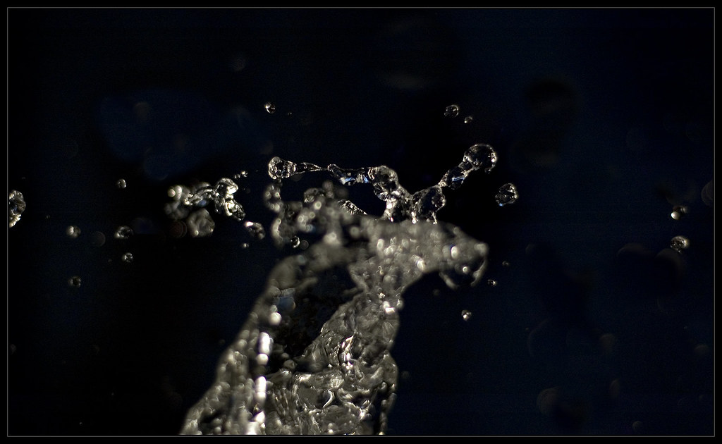

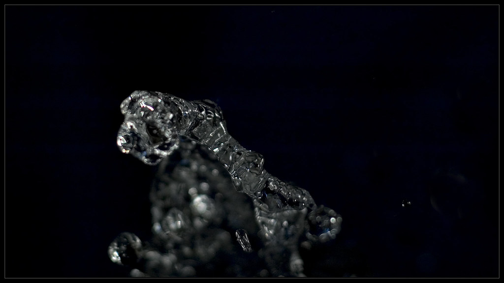

Took these with a friends (west_berliner) 50mm f1.8 nikkor lens. I took a long time of trail and error to get these. I had the d70s set up to 1/8000 f2. I had 3 500w halogen lights placed around the water. The water was in pan which was in a bigger pan to catch the water. Did it all in the garage, was pretty messy at the end. I made the splashes with a metal weight about the size of a socket.
Than in photoshop. I played around with the contrast, unsharp mask and curves. Also cloned out some chromatic abarations.
The challenge was to set the focus right. I tried to catch the front of the splash whenever possible. So dropping the weight in the same place was important. Just catching it at the right moment was pure chance. I set the camera to burst mode. But with Raw the time span is long between shots. probably took 400 exposures to get these 3.

I have tried this myself without much luck. What you have here is interesting, I espeacially like the last shot. I am wondering why you went with such a shallow DOF on these?
The reason for the shallow DOF:
I wanted to keep 1/8000 shutter speed to capture a crisp shot of the water. So that left only the aparture to play with. Anything above f2.5 left me very dark photos. I didn't have anymore lights to set up and the 3 500w were getting the room pretty hot already. So I tried a higher aparture with a higher ISO. That worked but it lit up the background and I wanted to keep it black.
I see, thanks for the info. 1/8000 is kind of extreme, 1/500 to 1/1000 should keep it nice and crisp and give you more latitude to play with should you want it, just an idea :)
Hmm maybe your right. I tried it at those shutter speeds. I was consistently getting blurry photos but maybe it was just out of focus.

like i told you before, i really like 2 due to the shape. its a really strange, interesting shape.
