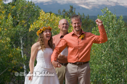

4 - Bride and groom while a family friend was playing the guitar, officiate (Groom's dad) behind them. Vignette.

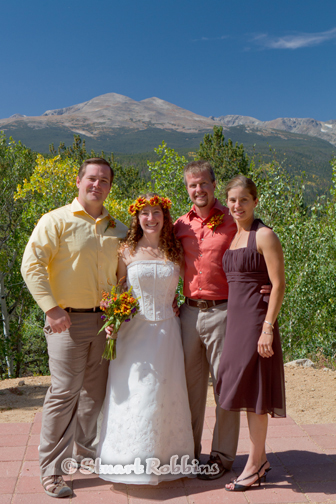

6 - Man and wife.

#4 & #7 are your best emotion shots. Emotion is what brides want to see and what photographers should look for. They are look

4- very nice candid emotion shot. Would like it with less vignette, but this is the type of image I like to capture.

6- Would of loved a much closer in shot of this. the setting looks so nice with the mountain in the back...closer crop of just the couple and the mountain would be nice. Why did you shoot from so far out?

For 6, I have several tighter shots, and I can heavily crop it since I was using my 7D. That was the wide shot I wanted to show at this point (a) because it got the whole group, and (b) to, as I said, reserve a few of the best ones for later so they're not disappointed.
