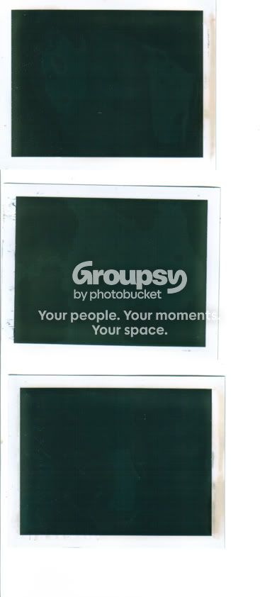

Yes my film finally arrived, loaded it up and everything and went to print, and so far I have 6 very blue polaroids :( Ive fiddled with the slide printer settings but I believe its the actual film, cos theres no difference in any of the polaroids :(
So now Im ordering more (again) my question is - could it be expired or could it be some other reason? Anyone whose had experience with this please weigh in!

Is it a pure blue, or does it have that distinct *cyan* tone that 669 can have? (More greenish blue.)
Was the film at room temp when you started? 669 is famous for keeping that cyan cast, if it's too cool.
You're using the Vivitar, right? Correct me if I'm wrong, but you can add gelatin filters if you want. To ease a cyan cast, you should add a red (magenta) and yellow filter. You should see more normal tones with added color filtration, but then of course it's trial by error and can burn some more prints.

Well the thing is that there is zero detail - the whole thing is blue. I'm really disappointed :roll: oh yes I know, woe is me :lmao:

You're not getting any image projected onto the film? Is that what's happening? It may or may not be the film, then. When's the last time you used the Vivitar - has it been in good working order?
It's been a long time since I used 669, are you sure you pulled the dark slide? (I don't remember if it auto-ejects when you put in the film pack!)
Yep I pulled the dark slide, I also loaded the 2nd packet into the polaroid camera, being as its my first time actually using the vivitar, I thought it could be operator error, but Im still getting the same thing.
Ill scan one of the roids to show you, back in a bit.
Well theyve scanned a lot darker than what they actually look like.
And I have no idea what the ghostly things are on the actual polaroids :er:
I would have been tempted to blame the Vivitar, since you don't have a working history with it. BUT - since you've tested the other pack on your camera and are getting the same results, I'd say you were due some new film, Missy. How bizarre, and I haven't a clue. :scratch:
I'd call Polaroid's technical assistance/help line (it's on the site, under "creative" I believe) and have the batch or Lot# from this film ready to give them. Who knows, they might already know about it and are waiting for consumers to call!

Thanks guys, I was so disappointed yesterday I marched right to my computer to order from bh :lol: that'll teach me for not sticking with what works. On the bright side I did get a refund from the ebayer that sold me the film.
That explains SO much. :mrgreen:
I'm just glad it's not the Vivitar!
