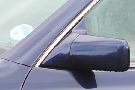

Watling for a friend to arrive and being a little bored and trying to learn more about this new to me camera i took some pictures of my car at the various quality settings on my Nikon D700 with a nice prime Nikkor 85mm 1.8 lens
settings were RAW TIFF JPEG Fine, Normal and then Basic
Blowing them up to full size i could not see much difference - at 400% not a lot of difference either and i dont have time ATM to do a print out - is the problem my screen resolution or?
ORIGINAL PICTURE
RAW
TIFF
JPEG FINE
JPEG NORMAL
JPEG BASIC

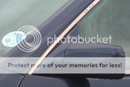

I can reproduce the various compression levels just by taking an image and saving it at different JPEG percent levels.
I'll use this image for a demonstration:
I will save this image at 100%, 80%, 60%, 40% and 20% levels, and run the magnification up to 800% to view the area in the black box.
At 100%, you get all the detail the camera saved.
At 80%, I threw away some of the data. You really can't see much difference, but the file size is smaller.
At 60%, you start to see some of the effects of pitching data overboard.
At 40%, it really starts to get bad.
At 20%, it's hopeless.
The crops are as big magnification wise as i can make them and i dont see any real differences in the JPEG crops that i posted here apart from there being more colour in the tax disc/road fund licence on the normal and the basic which seems perverse.
I fully appreciate that the RAW image IS RAW Data i just expected that to be more punchy
The JPEG's dont have any additional sharpening or increased saturation contrast etc. everything is set as normal I do appreciate that the camera does some work on the RAW image to get a JPEG using in camera set parameters such as white balance, saturation, sharpness, contrast etc then it is subjected to the JPEG compression before being written to the memory card. Also i fully appreciate that the RAW is 14 bit and the JPEG is 8 bit
Looking at what i have posted here - can you really see differences in the JPEG images?
Also the TIFF looks the best and it is lossless compression BUT it is enormous RAW is 14.6 TIFF is 35.9 JPEG FINE is 2.5 JPEG NORMAL is 5.7 JPED BASIC is 2.9 Now there is a thing i had assumed fine compression was less work on the image and basic was the most work on the image that would appear to be arse about tit. Need to go RTFM again.
yes i totally get that - but you are saving a compressed file (which means you have to throw away lots of the image data) then enlarging it back up - you cant recreate image data that is not there so you have to do some clever averaging or something like that - you are not doing that in camera - what i was comparing was in camera compression.
Changing the camera's setting from Fine to Normal or Normal to Basic does the same thing. Not that Basic saves the image at 20%, but the principle is identical. Fine may be saving the image at the equivalent of 95 or 100%, Normal might be in the 70-90% range and Basic in the 60-80% area.
The part that you are missing is that when the JPEG is created, the sharpening, contrast, white balance, etc are all a part of the image. You can't go back and say I would have liked a little less sharpening, or if shooting B&W, you don't get to go back and decide you want color.
The main issues are the exposure and white balance. RAW gives you a bit more control over exposure adjustments because a lot of what a JPEG throws away is at the high end of the exposure levels...i.e, the whites. White balance is a completely different story. We've all seen the horrible greens or blue color casts by a wrong white balance. In RAW, it can be adjusted afterwards.
If you're work isn't all that critical, or you always make sure everything is spot on, and you can customize the picture controls to your liking, then I would say you aren't missing anything. Sounds like there would be no advantage to you shooting RAW and possibly a few disadvantages.
As far as the JPEG settings, I would tend to agree with your assessment. JPEG Normal would probably meet the requirements of 99% of the shooters who don't need the additional options from RAW.

au contraire - did you not read what i wrote previously " I do appreciate that the camera does some work on the RAW image to get a JPEG using in camera set parameters such as white balance, saturation, sharpness, contrast etc then it is subjected to the JPEG compression before being written to the memory card. Also i fully appreciate that the RAW is 14 bit and the JPEG is 8 bit"
And i fullyappreaciate that i can tweak these setting in a positive and a negative way in camera.
I also fully understand why in extremis i might want to shoot RAW so i can play around with the RAW data to get whatever i want from the images assuming that is possible and shooting RAW will give me a better chance of getting what i want rather than manipulating a JPEG Image.
Sadly this appears to have drifted into the technicalities of RAW vs JPEG
ALL and i repeat ALL i am asking is can YOU see any differences in the three crops i took at the three different JPEG compression levels available to me on the D700 I CANT.
Ignoring the percentages that is what i had assumed however from the post i made previously that seems not to be the case. Fine is smallest file size Basic is larger again with Normal being the largest - see below

yes i did read it all but you did say "the part that I was missing is" - difficult as it is here i will accept that this was not actually what you mean to say - had you said I see you understand that when the.......................... then i would not have needed to reply to your post
HOWEVER my initial question is still open and un-answered can you see any differences in the three JPEG Crops? Yes No Maybe are all valid answers :-)
Your JPEG fine is out of focus ;) that I can see clearly.
Also remember that many of these finer points might not show up in the first save (ie initial recording in the camera) of the photo; the little differences won't be that visible in ideal conditions. However start playing with the curves, saturation, contrast, white balance, etc... Once you start editing even if you only edit a little, the differences between the compressions on JPEG will start to show. Your JPEG fine will weather the best, whilst the smaller versions will start to show more banding, artifacts and other limitations more rapidly.
That is in addition to what Sparky said in his first post, last paragraph - where you end up getting worse graduations in the original even before editing (remembering that the camera, even on basic, is applying some editing to the photo).
Generally speaking, with memory cards so comparatively cheap, you'd generally never have an excuse not to shoot in at least JPEG fine - - shooting lower only if you are really forced by the conditions.
Okay, we'll try again. With JPEG compression, what you are throwing away is color data. A Jpeg works by looking for areas of similar color and grouping them together. The Basic, Normal, and Fine options allow you to choose the standard that is used when it comes to differentiating color detail.
The image you chose does not have a lot of gradients. It has a few relatively solid colors so you would be unlikely to see a huge difference in this shot. As far as the file size discrepancy, you missed focus on the jpeg fine which blurred some of the colors together and allowed the JPEG engine to group more of the colors together, which is what resulted in the smaller file size.

NO one answered the question i asked really - hocus focus!!! - actually what i did was accidentally mix up my naming of the crops - the camera is set so the shutter is locked out until it gets a focus lock - so i cant see how I or it missed focus - but lets not go there - i really was just looking out the window and wondering about JPEG quality i did not set up a full tonal test or do anything other than take that shot - but if all i have learned is that my understanding of Fine Normal & Basic is correct that will do for today
