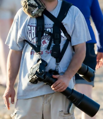

As jamesdak said if you are crafty you can set yourself up with a easy setup to carry big lenses, this is my rig... If you want more info ask..
