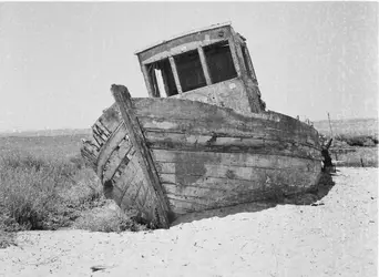

Hello everyone,
I'm new to film photography and i'm trying to develop my film at home but without good results.
Every time i develop a roll of film i end up with white spots all over the photo.
I've attached an example of my last developement.
Developed a roll of 120 Ilford Delta 100 on a Paterson tank with the turning stick, Ilford DD-X 1:4, 20 ºC 12min | Ilford Stop Bath 1min | Ilford Rapid Fixer 7min | tap water for the final rinse and Kodak photo-flo at the end.
Can anyone give me some ideas on what this can be?
Thanks in advance.

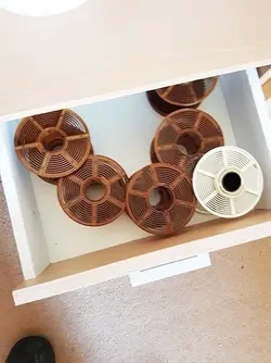

As an aside, I have used Paterson tanks for almost sixty years and my current tanks/spirals are forty years old so with care and good cleaning you shouldn't have any issues however, rotary development with the twizzle stick is not recommended by Ilford and I have never known any photographer that uses it. Here are a few of my spirals, stained from colour chemicals but still going strong after a few decades.
To be fair these spirals were only used for colour and hardly get used these days as I don't use colour now and as I only process perhaps one or perhaps two films a month I just use a couple of spirals that I kept for B&W.
With regards to cleaning, , I wash everything in warm soapy water and then gently brush round the spirals with a a natural bristle nail brush (very hard to find now) rather than the modern nylon type ones as I find them quite harsh on the relatively soft plastic tank parts. A word of caution: never use any type of cloth to dry the tank components because I find even the finest cotton or cotton blend material will shed very small fibres and leave them on the components ready to be washed into the chemicals next time you fill the tank, even monofilament cloths seem to leave something behind. I then leave mine to air dry on a stainless steel rack in a cool room and alway, always blow them with a rocket blower or similar before use. I realise that some will heartily disagree with me and say it's a bit OTT but hey, it works for me.
