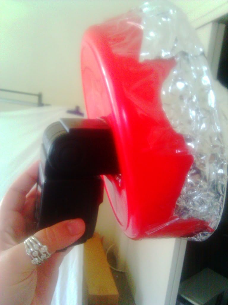

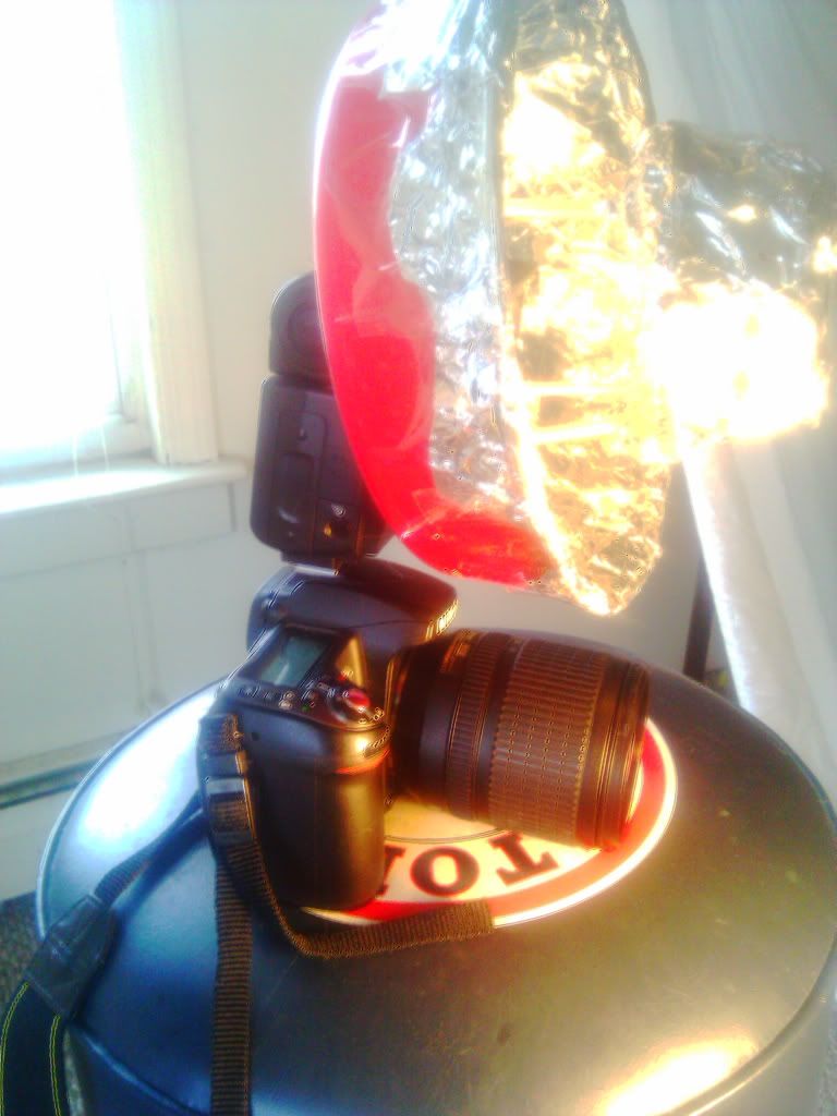

And then that wasn't enough, so I made a home made beauty dish out of 2 tupperware bowls, 4 straws, and tin foil. Here is the dish:

With the beauty dish, it appears that the flash is mounted on camera because the catch lights are still kinda-sorta in the middle of the pupil. With the D80 and SB600, use the CLS to your advantage and get it off camera. Even though the pre-flash does not contribute to the scene, you will find that it does have an effect on reflective objects, such as puplis. I have fashioned tin foil (since you're on a mission with it) to fit over the built-in flash (which triggers the off camera flash) so that it activates the flash unit but is non-descript to my subject. Hell, I've even had it to trigger a flash that was a few feet behind me. Here is an example....

Ridiculous.
A Tupperware bowl with a hole cut in it with a flash stuck in the hole, and tin foil flapping around all over the place.
Are those sippy straws being used to reinforce the concoction?
Put your hands up and step away from the camera.
Why not BUY the proper equipment??????????
Ridiculous.
At least she takes good shots with her homemade equipment. Some people can't take good shots with the official equipment they got.
I dig the ingenuity, but I don't think I'd ever pull that outside of my house hah.
