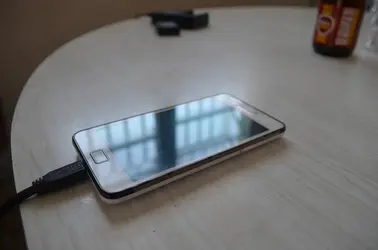

This is an AUTO shot at 1/80, f4.5

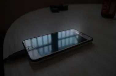

Manual shot at 1/80, f4.5
The ISO must be changing. There's no EXIF information with the image so it doesn't show ISO. It's possible that your auto mode is using auto ISO and the manual mode is not.
Using EXIF, the AUTO shot has a EXP. MODE, ISO: (AUTO), 400
Whereas in Manual, EXP. MODE, ISO: M, 100
1/80 is your shutter speed, not your ISO. As in, the shutter is open for 1/80th of a second.
Your ISO is how much the signal on your sensor is boosted. It takes the form of multiples of 100 in most digital cameras, by multiples of 2, so 100, 200, 400, 800, 1600, etc.
There are THREE exposure variables (Shutter, Aperture, ISO), and you're only showing us two of them. The one you're not showing us is probably changing, which is ISO.
There is your answer. There is a two stop difference iso100 and iso 400 which accounts for the difference in the image you posted.
