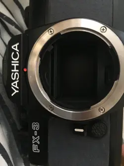

Do we have the same problem? Mine looks like this. The mirror is completely stuck upwards. It goes down whenever I pull the little lever (the one that looks like an arrow, located below. idk what it is called). It gets stuck sometimes, sometimes not at all. Any suggestion? Thank you!

It seems it is a different problem. Mine was that the mirror had gotten displaced from its intended position and so it was getting stuck with lens while taking photo. Since the camera operation proceeds only when the mirror is fully up, it was not taking the picture in my case. The operation would complete if I took out the lens or focused on a nearer object(The back of the lens protrudes out a bit when focused to infinity).
Your case seems to be a sticky mirror or misaligned/bent metal getting lightly stuck. Fix could be to blow pressurized air etc and hope to remove any dust etc stopping the operation or may be completely open the camera, take the mirror box out, clean it with lighter fluid thoroughly.
I had done this completely some days back but unfortunately I have deleted all the pictures I took in the process. If you want to attempt it yourself, I can help where possible. It is not too difficult if you have the knack for it. Just remember to keep taking photos at each stage so you know how to re-assemble.
